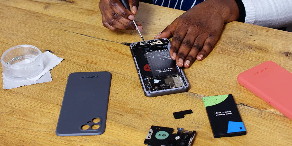

Affordable spare parts for easy DIY repairs make Fairphone a more economic and environmentally sound solution.
This brings us to the actual modules and the connectors Ternus is talking about. Over the last four generations of the Fairphone, we have been actively working to reduce the number of connectors we need for the different components the Fairphone houses. Compared to earlier models, the carbon footprint of the additional material needed to make a product modular accounts for approximately 1% of the overall production impact. As per the Fairphone 4 Life Cycle Assessment Report compiled by the Fraunhofer Institute for Reliability and Microintegration (IZM) in Germany, the design of Fairphone 4 also incorporates fewer connectors than earlier models and is comparable to other, non-modular latest generation models from other manufacturers.
This, simply put, means Ternus’ concern about more connectors and an increased carbon footprint is largely unfounded. By offering affordable spare parts for easy DIY repairs, Fairphone is offering a much more economic and a potentially more environmentally sound solution.

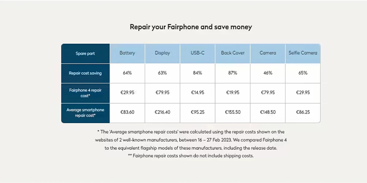

Make no mistake, we are not saying Apple’s idea of durability is wrong. The brand value and awareness that Apple has in place ensures that iPhones do have a much higher chance of resale compared to other manufacturers currently. Apple’s approach to extended software support is also very commendable and shows their effort to extend their products’ usability. This scientific paper published by the Journal of Industrial Ecology  implies that it is “rather products with longer economic lifespans (defined here as the time during which a product can be resold ‘as is’ via second hand markets) that are generally more sustainable than products that lose their value faster and have shorter economic lifespans.” However, this makes an even bigger case for repairability, especially for Apple. With modularity, Apple could extend their device longevity and economic lifespan beyond the industry average of three years. With modularity, Apple could even explore device upgradeability like Fairphone did in the past. Our easily repairable design allowed Fairphone 3 users to upgrade their cameras and other components to match the newer Fairphone 3+ for a fraction of the cost of the new device. In the long run, Apple’s environmental impact would be less damaging. We have successfully managed to extend the lifespan of our Fairphone 3 and 4 devices compared to the market average, meaning that most of them are now actively avoiding emissions that would have been caused by manufacturing new devices.
Fairphone’s approach to modularity results in serious savings for the end user.
