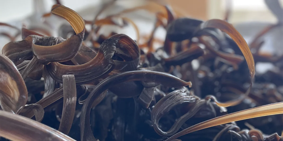

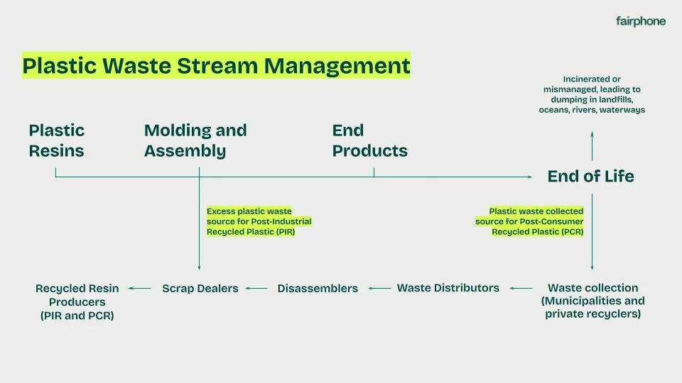

Unfortunately, a lot of plastic waste is lost to landfills or, worse, incinerated. Then there’s the problem of mismanagement, leading to plastic dumping in oceans, rivers, and other water bodies. The portion that does manage to enter recycling streams is collected by either local municipalities, or private parties, ranging from big corporations to independent waste-pickers. The collected plastic waste then makes it way to waste distributors, who then sent it to disassemblers, scrap dealers and recycled resin producers. The entire process involves disassembling, shredding, and cleaning. Eventually, the plastic mass that results from this is heated up and melted to make noodle-like strands, that are cut into raw plastic pellets.

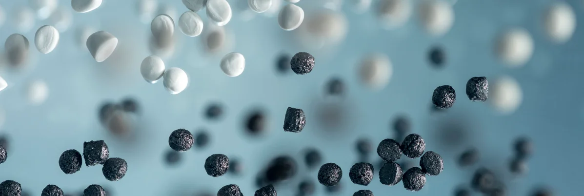

These raw pellets then go through a compounding process, where additives are added to modify the properties of the pellets to optimize them for injection molding. These modified pellets are what we use in our manufacturing process. This entire process is anywhere between 50% to 80% less carbon-intensive than compared to creating virgin plastic. This makes perfect sense, given that you are bypassing the raw material exploitation, and the energy-intensive distillation, polymerization and granulation processes involved in making plastic out of raw petroleum.
