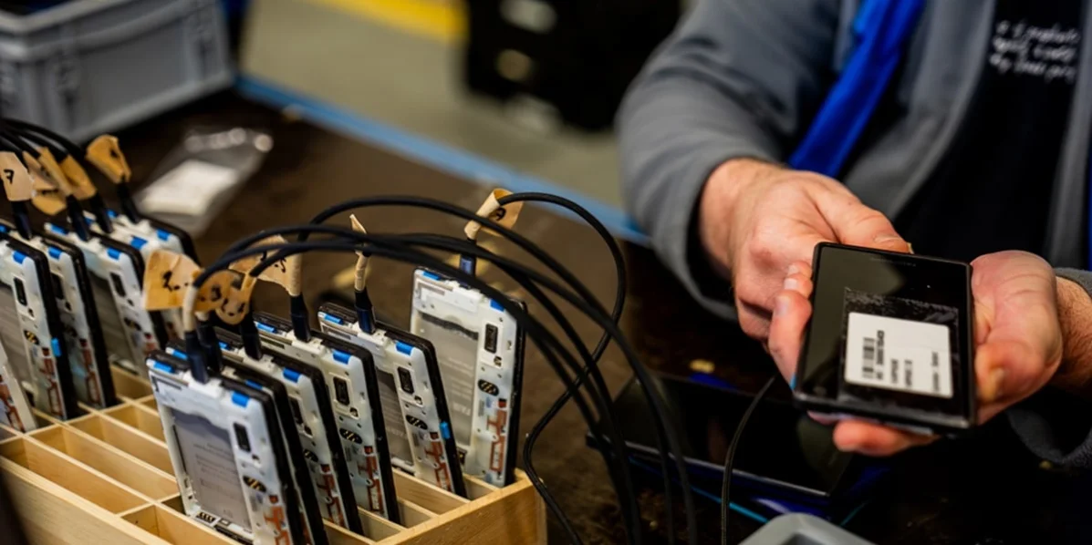

Devices can look broken, but that doesn’t mean everything inside is broken. Citronics live tests our old Fairphone 2s on their industrial floors, and extracts the working components. ©2024 – Citronics

The first thing we do is check if the device is live or not. Devices can look broken, but that doesn’t mean everything inside is broken. So on our industrial floors, we do a live test to see what’s working and what’s not. The motherboard extraction process is mainly a disassembly process. We sort all the components by materials (plastics, metal, and so on) or by re-use potential: we are already reusing the screws, and in the future, we will be reusing the screens definitely. There is a lot of potential with other Fairphone 2 modules as well, such as the cameras, the speakers and mics, and the USB ports. So we store them safely for now. Once the components are extracted and sorted, they are reprogrammed and tested. Once they are good to go, they are used in either our product assembly process, or shipped to B2B clients who need these parts. Everything is shipped out of the industrial floor.
